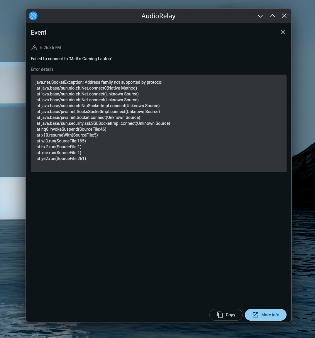

The app discovers the other device and attempts to connect, but fails with:
java.net.SocketException: Address family not supported by protocol
at java.base/sun.nio.ch.Net.connect0(Native Method)
at java.base/sun.nio.ch.Net.connect(Unknown Source)
at java.base/sun.nio.ch.NioSocketImpl.connect(Unknown Source)
at java.base/java.net.SocksSocketImpl.connect(Unknown Source)
at java.base/java.net.Socket.connect(Unknown Source)
at java.base/sun.security.ssl.SSLSocketImpl.connect(Unknown Source)
at nq6.invokeSuspend(SourceFile:46)
at x10.resumeWith(SourceFile:5)
at wj3.run(SourceFile:165)
at hx7.run(SourceFile:1)
at xne.run(SourceFile:1)
at y62.run(SourceFile:261)

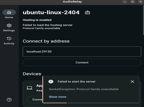

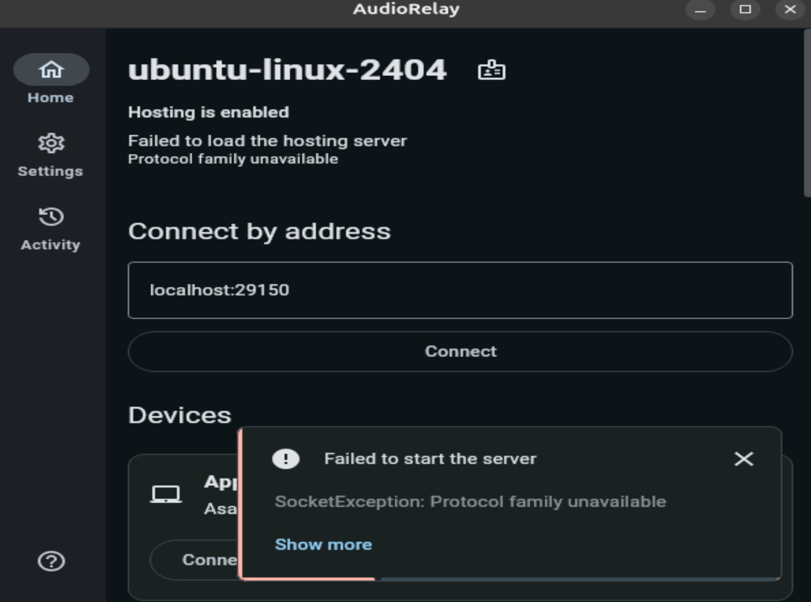

I also saw related errors earlier:
Failed to start the legacy server on port 0
java.net.SocketException: Protocol family unavailable
Creating the search socket failed
java.nio.channels.UnsupportedAddressTypeException
UDP search failed
com.azefsw.audioconnect.discovery.search.ServerSearchException: java.nio.channels.UnsupportedAddressTypeException
IPv6 is enabled on the system, and nothing appears to be using port 29150. I also tried forcing IPv4 with Java options, but the same bind/connect issue remained. Replacing the bundled runtime with system Java 26 got past some networking behavior but crashed Skiko/UI, so it seems tied to the bundled runtime or native networking behavior on this distro/kernel.

Can confirm it just chokes on .local but connecting to the ip directly works fine:
1.0.0-alpha07 2026-05-14 01:33:12.615 INFO    Dispatcher-worker-12 kt                   zeroconf registration
established
1.0.0-alpha07 2026-05-14 01:33:24.252 INFO    AWT-EventQueue-0                          Requesting connection
to Matthews-Mac-mini
1.0.0-alpha07 2026-05-14 01:33:24.256 INFO    tDispatcher-worker-3                      Connecting to server:
Matthews-Mac-mini.local:29150...
1.0.0-alpha07 2026-05-14 01:33:24.257 INFO    tDispatcher-worker-3                      Binding to local addre
ss WithoutPort(host=192.168.1.2, networkIdentity=Indexed(index=2, name='enp4s0')) which corresponds to the net
work interface enp4s0...
1.0.0-alpha07 2026-05-14 01:33:24.257 INFO    tDispatcher-worker-3                      Connecting to Matthews
1.0.0-alpha07 2026-05-14 01:33:24.257 INFO    tDispatcher-worker-3                      Initial RSocket connec
tion failed: Address family not supported by protocol
1.0.0-alpha07 2026-05-14 01:33:24.257 WARNING tDispatcher-worker-3 kx1                  Connecting to 'Matthew
s-Mac-mini' (WithPort(host=Matthews-Mac-mini.local, port=29150, networkIdentity=Indexed(index=2, name='enp4s0'
))) failed
Thanks for reporting back, could you please also confirm whether it fails to connect if you select one of IPv6 address(es)? Or is it just when connecting via the .local address?
Only works on ipv4 in this build.
So for now, the app will prioritize IPv4 addresses. (Since since 1.0.0-alpha08)
