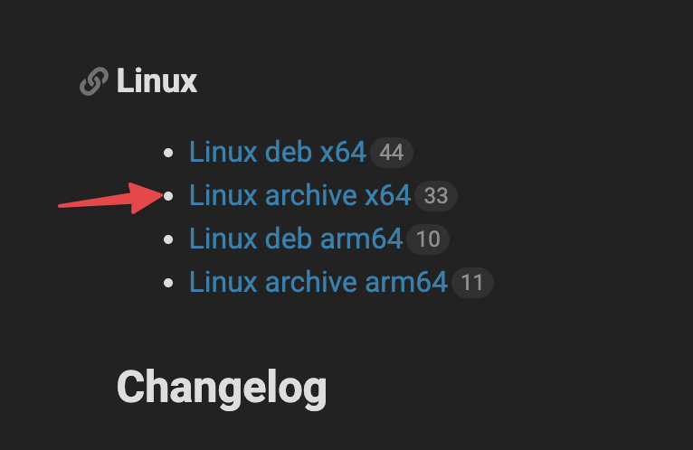

Hi, noted. Does the app still work on your end if you use the archive version?
When I tried to install version 0.27.5, I got this error: audiorelay:amd64 Depends libflac8. That package also doesn’t exist in the repositories.
I meant that instead of installing the .deb version, you use the archive (.tar.gz) from the current topic
It does work if I use the archive.
