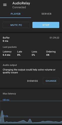

How are the stats and the graph when this happens?
All at 0, graph missing, graph and stats still being updated etc.
See the picture below:
Maybe the audio driver stops sending audio but doesn’t notify AudioRelay of any error… :thinking:

Luckily, the bug occurred on my end. The audio is correctly sent to the Android device but all the packets are rejected for being “out of order”. It probably happens after a temporary connection loss.
I’ll try to fix it.

Now the audio seems to work on the app, but you can’t hear any sound. Same error (for the user), different behavior from the app.
I was listen to a YouTube video, when the video had end and I’ve started another (I’ve changed pages, searched and put to play the new one) the error happened.
While I was writing these post, with my server restarted (changing the audio output for restart the server faster) I kept the server without audio for 6 minutes, when I played an audio again the app behaved the same way as before, “Ordering Not OK” and then, Ordering changed to “OK”, the “Max latency” returned to count but the audio didn’t have any sound (like in the print before the restart). Restarting again, worked again.
