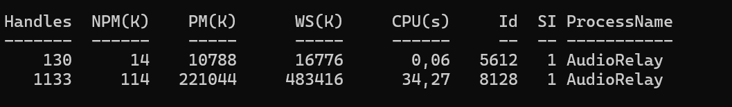

Good, some progress!
Before starting, the app checks if another instance of AudioRelay is already running.
In your case, either there’s still a trailing AudioRelay process running, or the path to $env:LOCALAPPDATA/AudioRelay/locks/instance is made inaccessible by something.
Please try to run
Get-Process -Name AudioRelay
Does it list anything such as this?
If so, try
Stop-Process -Name AudioRelay
Then
Remove-Item $env:LOCALAPPDATA/AudioRelay/locks/instance
(Please post the result if it fails)
